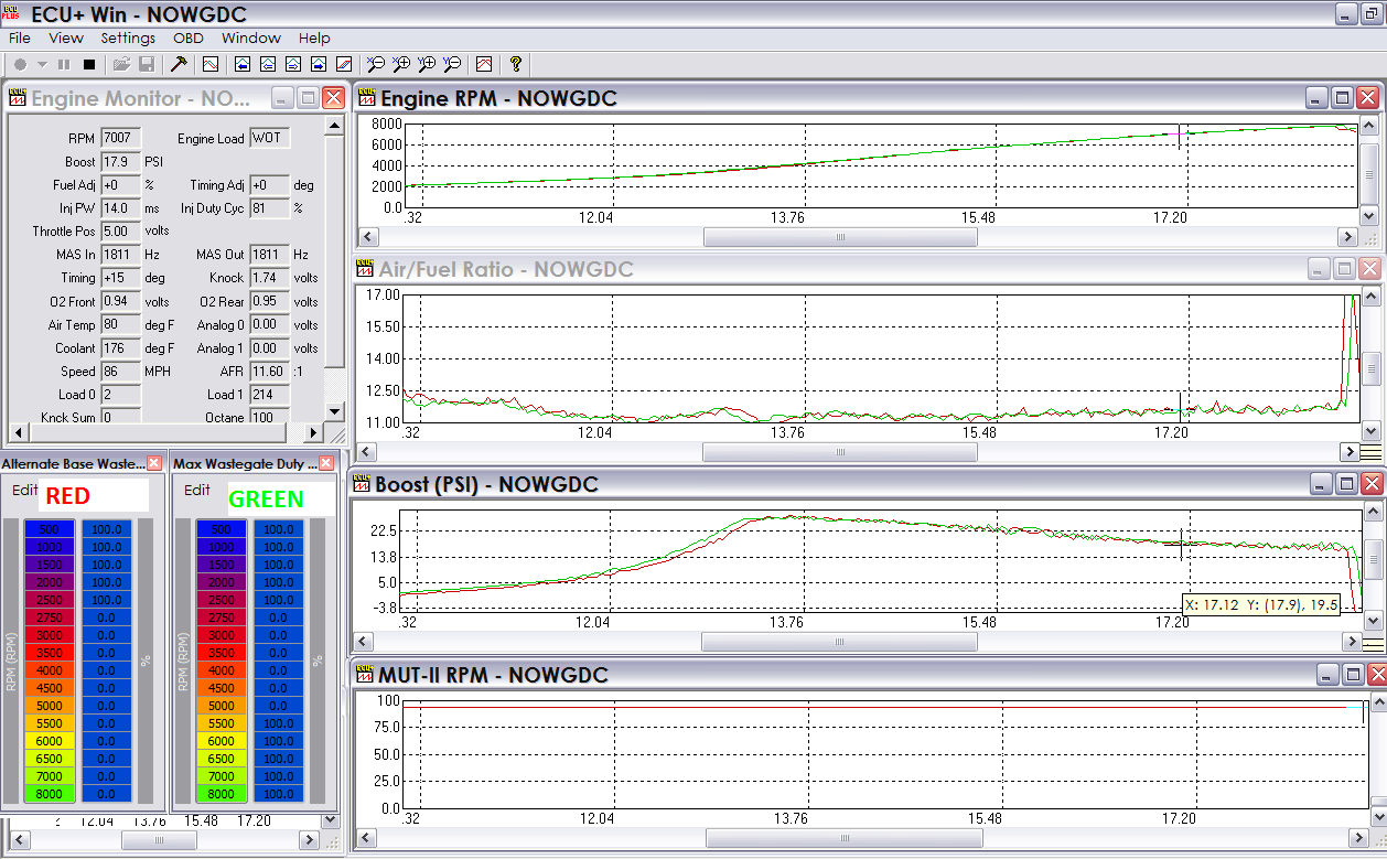

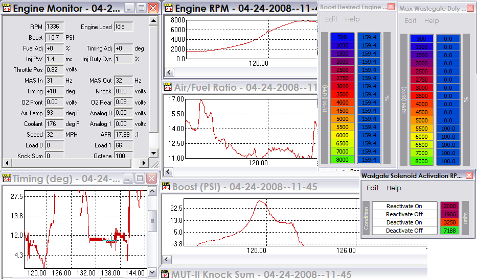

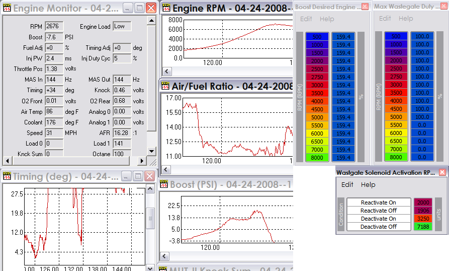

Alright, set it up as bleed and ran the "piping" exactly like cookie's diagram. The red plot below uses the WGDC map w/ "RED" on it, and the green plot uses the WGDC map w/ the "GREEN" on it. As you can see this didn't work at all... Gotta get to work, but I'll ponder this a bit more soon.
Please forgive the size.
