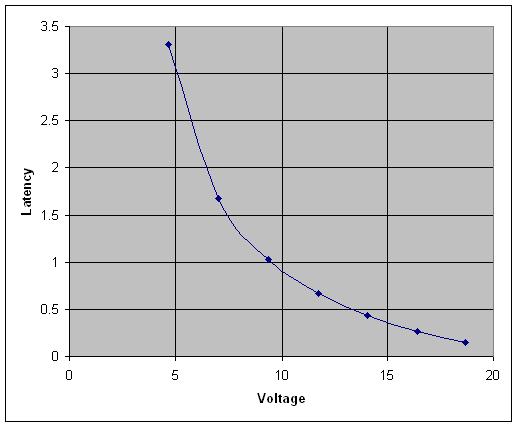

Each voltage is just to charterize the reaction time that the injectors will have at that voltage. I would guess 99% of the time, you are anywhere from 12.5-14.5 V, depending on the output from your alternator.
One setting isn't for idle, or cruise, or WOT. It simply is a compensation table for the reaction times of your injectors at different voltages. Injectors react more quickly as voltage goes up and slower when voltage goes down. Some people just tune the two cells for 11.72 and 14.06 V, since those are the only two you are really using during driving, but I would always scale all of them, so you keep the shape of the curve the same. To keep it easy, adjust all of them by the same amount, so you are simply shifting the entire curve. This way your injectors will be scaled correctly for whatever voltage your car is operating at.
As far as why the other voltage cells are there, I would guess possiblly for cranking where voltage may be low, or just for general voltage fluctuations that may occur. I'm sure there are other reasons as well that I'm not thinking of.
Edit: Just because graphs and pictures make it easier to understand things for me, here is the graph of the stock Evo injectors, voltage vs. latency. This shows how the latency changes to chaning voltages. When you scale and tune injectors, you want to keep this same basic shape, so you should be tuning all of the cells.
