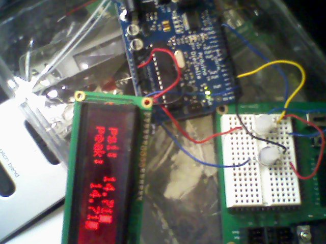

i am currently building my own gauge to monitor boost and afr.. a la zetronics.
i have spent about 70 bucks on the hardware and lcd so far, and i am currently writing the code.
the jdm sensor spits out a 5v signal as does the output wire from my innovate WB.
My hardware [adruino board] has 6, 5v inputs with a built in ADC for conversion.
I have boost, peak boost, a boost graph, two warning levels [set at 20 psi and 24psi], and similar functions for afr. I am displaying it on small two line red lcd. In the end, this will have costed me less than 100 bucks for the hardware.. and a few weeks of coding.
lcd ... http://www.sparkfun.com/commerce/pro...roducts_id=812
hardware ... http://www.arduino.cc/en/Guide/Introduction

its a programmable micro chip with both digital and analog outputs. I dont see why it couldnt easily be hooked up to an analog gauge. My project isn't going in that direction, but ill add it to my list of things to do.

sounds like a very cool project, any idea when you will finish?
Old May 27, 2008 | 10:50 AM
budlong's Avatar
Posts: 512
From: norcal / socal
depends on when i get thru GTA IV
it's just coding at this point and then hookup, so i would assume around a month.
i am using an old parallax bread board to hold my potentiometers [to simulate the boost and afr inputs].
