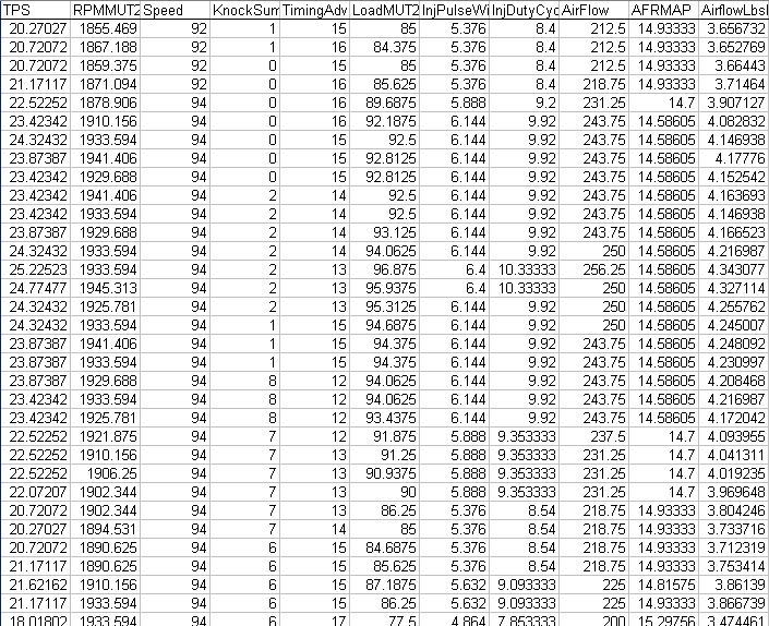

Take a look at this .... a knockcount of 8, out of the blue. Nothing changed except fuel being pulled.
Just wondering if I should even bother?

The easy thing to do is to take roughly 3 degrees out of that area of the map and see if the knock sum still happens. If it does, then it is fasle knock.
I would rule out clutch noise that most people are talking about. My car false knocked in the same regions and it is an auto! I raised the load threshhold a little for the knock control and no more problems. Before that I was in 36-knock land while cruising down the freeway like a Corolla.
