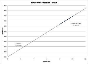

I'm working on characterizing the readings. Because a range is given, I am using the nominal values of the range for the data points.
For the baro sensor, assuming 0kPa=0 VDC, the equation Voltage(v)=0.0394*pressure(kPa) (R^2=0.9902)
Using a non-zero intercept gives
Voltage(v)=0.0387*pressure(kPa)+0.0677 (R62=0.9905)
Seems like the zero intercept is close enough?
Using an NTC Thermistor model:
Beta=3300 and Ro=6000 and it's a very good fit to the data
Attached is the Excel graphs of the data from the FSM and the curves above.
I'm hoping somebody can fill in the code to make full speed density work. I have access to pressure and temperature standards and I'd do what I can to test out and characterize sensors as replacements to implement speed density if needed.
cool dude. i'll log when i get a chance and see what i currently get and adjust fire accordingly unless you beat me to it.

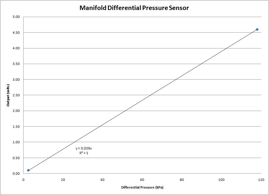

And for the MDP sensor
Voltage=0.039*pressure(kPa)
Only two data points, but the manual does state it's a linear sensor.
