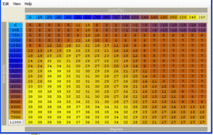

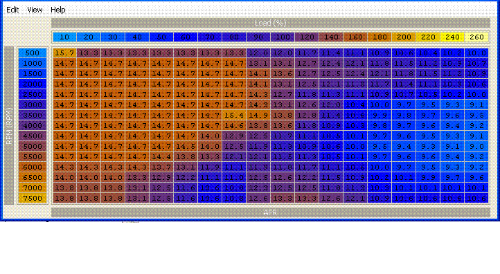

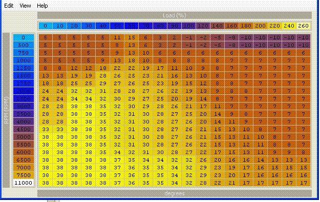

Just went to run some logs on a new tune i put in. Its just a real basic tune for now until I get my wideband and get tuned by mellon. I dont know too much about what the logs mean but I dont really like the knock im getting up top. I was hoping you guys could review my logs and tell me whats wrong. I will also post up the maps so you can see it and let me know what you think. I went back to the stock tune for now but I was wondering if you think it would be ok to go back to this tune and just drop some timing up top to get rid of the knock. Also if you guys could help me and let me know whats wrong on the map so i can maybe try to fix it. By the way I didnt make these maps I just put em on the car to hopefully help me out.
also to note: high and low fuel and timing maps are the same.
Here are the logs and maps below.
Attached Thumbnails Check my logs (KNOCK)-fuelmap.gif   Check my logs (KNOCK)-timing.gif

Why would you do that??? Put that back to stock. That tune is awful!!

wow soup sandwich

i don think there is any other way to fix that map than to start from scratch or go back to stock because im a little bit suprised that your car has not blown up yet

Holy timing batman!

in this case 7 is not your lucky number
