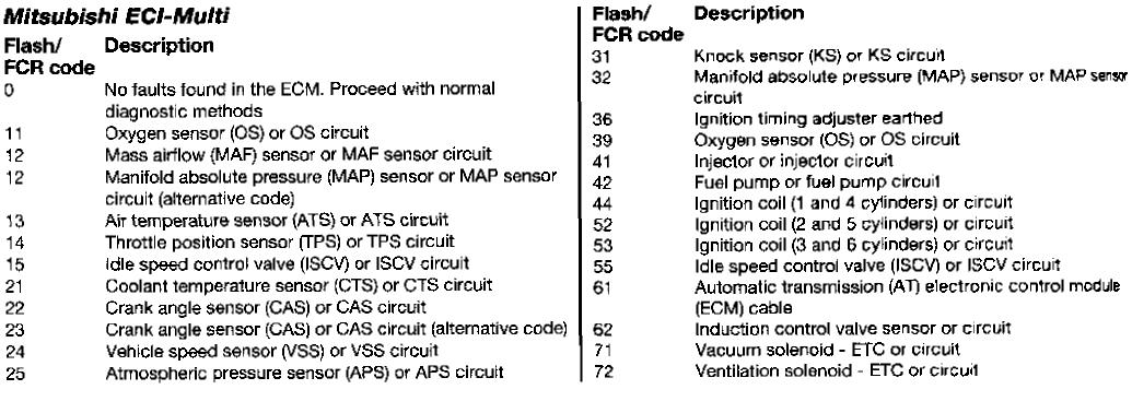

I just wanted to make sense of this table
