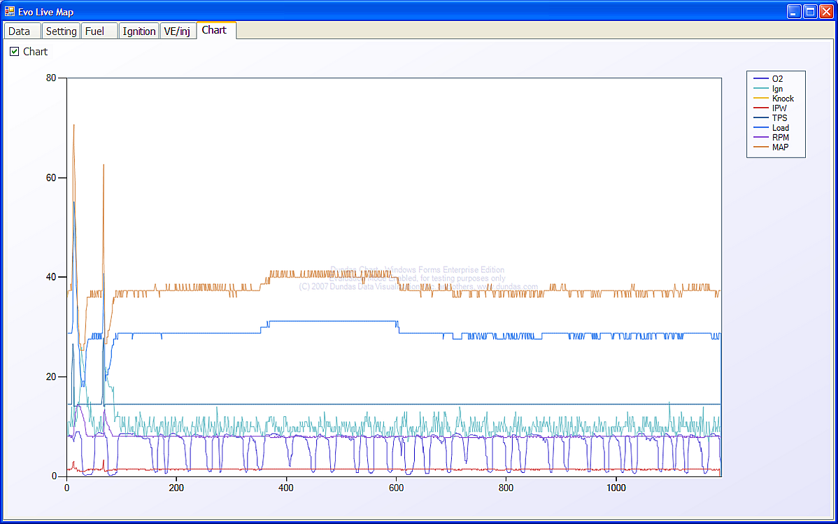

Added charting. Two problems, the logging goes from 1400 items per second down to 60 per second when I have it running, and the pastel colors aren't very clear.

Try using some queue, e.g. CompletionPort / Windows Message Queue, this should do the trick.

Originally Posted by jcsbanks
VB burns holes through my soul
I would like to use one xml file (probably not the Ecuflash one as it doesn't contain info about RAM maps, although they could be added) that has a list of tables that will appear, and the program will parse the xml and create all the tabs, editing buttons, read/write buttons and datagridviews necessary. It is quite a change though, which is why I previously abandoned editing anything in my application and was using Ecuflash, hitting ctrl-s and then clicking write in my app. Trouble with this is that you can't do map tracing, which really is quite useful.
If Ecuflash gets a logger, then hopefully buttons could be added to that to write maps to RAM using my DMA protocol, but with the source not being available or in a form I know how to quickly add things like this to, I'm stuck there.
The protocol to transfer a DMA block, from the PC side:
Ex, 4 byte address, 2 byte length, data (read indirect, read direct, write direct depending on x being 0,1,2)
Who creates the original xml file?
Old Apr 2, 2009 | 12:27 AM
  #39
codgi's Avatar
iTrader: (22)
Posts: 2,493
Likes: 41
From: Atlanta, GA
Both Overkill for this application. The first one is not really applicable since he'd have to PInvoke the living daylights out of VB just to use it and even then it is VB so blah. Proper multi-threading will solve the issue.

I've not attempted multithreading, but it looks like I'll get acceptable performance by using a few timers. Things run fast until the Dundas chart with 17 items is in view, so I can speed it up by only updating the chart twice a second on a timer. CPU usage goes down from 70% to about 20% and it is usable. Developing things like this is a real time eater, it took five hours yesterday to learn about and start playing with Dundas charts, then they run slow I would use my own graphics like I do on the Pocket PC and it scrolls nicely, but the same code doesn't work to scroll on the PC, and I can't work out why. I can run the actual Pocket PC application on the PC, and everything works except my scrolling.

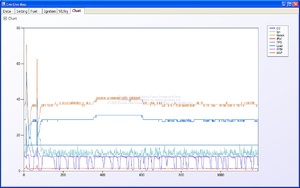

Better colors, and faster using just 8 items and Dundas Enterprise "fast line". You can scroll and zoom to review things afterwards. Not sure on the licensing arrangement though and whether I can distribute anything using the evaluation version, and the performance is still nothing like what my own code does on the Pocket PC. It is actually still the refresh speed of the Dundas chart that is the issue, and it seems slow in Evoscan as well.
What I need is more like an oscilloscope display, I want it to scroll smoothly like my old Amiga did
Pretty certain that the eval version probably can't be legally "shipped" with your code but there should be an EULA somewhere in the download.
