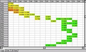

Originally Posted by 03whitegsr
Very kind to say, however I've just fiddled with it a bit, I wouldn't call myself a guru.
I may have different goals then what others may want to use it for. I just want 1st and 2nd gear to hit hard and be crisp without causing tuning issues in 3rd and 4th.
Same here. I would like to see stable mid 11 after spool up and all the way to redline on 3rd and 4th gear, but also get a benefit from mid to low 12 on 1st and 2nd.
You can see what I have with LS disabled (93 octane US). The car feels peppy enough, but i would like to try tuning LS myself too. Thinking about this LS AFR mapping:
14.7 13.06 11.76 10.69 09.80 9.04 8.40
14.7 13.06 12.54 11.47 10.57 9.85 9.17
...or even milder.
Have you tried to tune trailing time tables?
Could you recomend any other base settings to start with?
