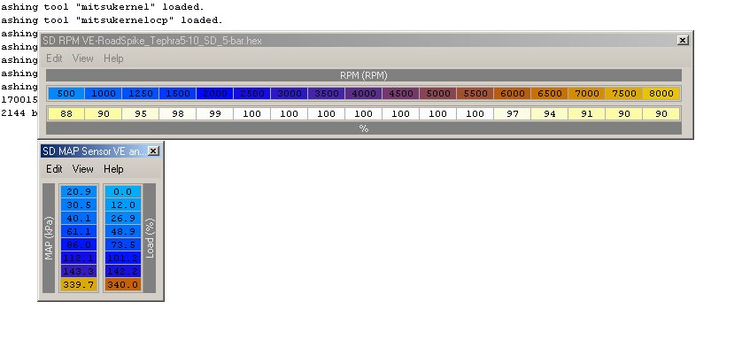

Interesting when i was tuning with the Red and speed density what i had to do was leave the RPM VE values near where banks set them and tun the low load are of the MAP to match the AFR 14.7 in open loop to get it right. I ended up with a slight sliding curve downward from 120map down to 0.
It looks pretty funky but it doesn't present me with any weirdness now. No rich dips at low loads and no lean spots no matter where i mash on the throttle. I could post a screen shot if you guys want.

I think that would be awesome if you are willing to do that. I am feeling that with the advent of SD and these other MAP sensors (non-OE) a thread akin to the injector scaling or MIVEC thread will be a good idea.
Sure
