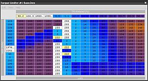

Has anyone been tuning the 08+ Ralliart cars? I have a ROM with an ID of 53600010. The torque limiting tables are not complete with the definition file. I have attached an image of what I am getting. Does anyone have the correct definition for this?

<table name="Torque Limiter #1" address="6386d">
<table name="Throttle" address="63dce"/>
<table name="Y" address="63da6"/>
</table>
<table name="Torque Limiter #2" address="63963">
</table>
<table name="Torque Limiter #3" address="63a59">
</table>
<table name="Torque Limiter #4" address="63b4f">
<table name="X" address="63e8e"/>
<table name="Y" address="63df0"/>
</table>
<table name="Flow Check table" address="63c19">
<table name="X" address="63ed0"/>
<table name="Y" address="63eb8"/>
</table>
