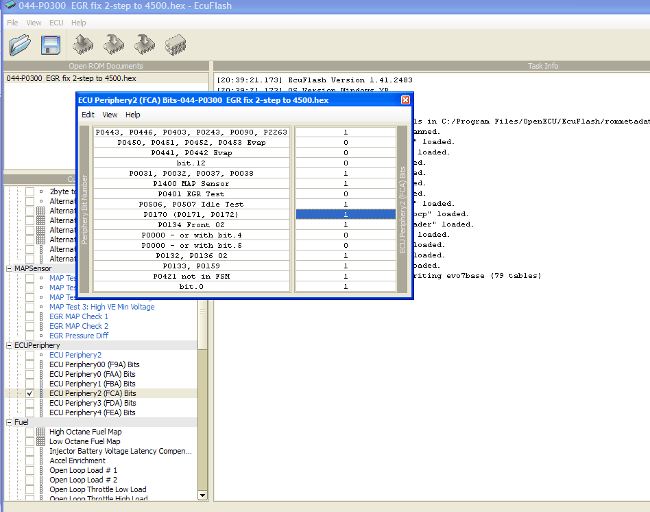

you can disable it in the ecu periphery 2 FCA set bit 8 to 0.

Thank you, this will give me something to work with ... but are you sure that's not bit 7?

You are right. Long day of racing yesterday.
