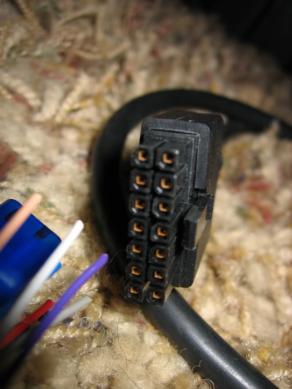

I log with my LM2 by running the output directly into the ecu. I had to buy some ecu pins to do this of course.

Old Nov 4, 2009 | 03:17 PM
RAbishi's Avatar
Posts: 942
From: South Dakota
Originally Posted by Danieln
What pin you use?
What connection do you use between LM2 and ECU?
I followed the directions in this thread.
https://www.evolutionm.net/forums/ec...ial-cable.html
I used the input/output cable that came with my lm-2. This is the connector and these are the two wires that you use. One wire goes to the ecu and the other is grounded.
