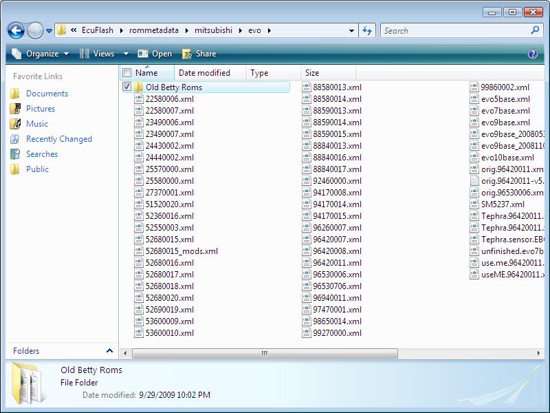

Ok, apologize for holding everyone up. Here we go...
This is a snap shot representing the rommetadata location in your pc, where the program finds it's info.
As you can see, i have a spare folder (only folder in this area) that has all my spare, and retired versions of the ROMID.xml and evo7base.xml. I have since moved it to another location, but putting it back for example.
What was very interesting is that even with these files seperated, but still in the home directory for the program, the ecuflash still will seek and interpolate the xmls into the ones that show in the normal metadata location, when in the ECUFlash program. So in essence, it is pulling info from 8~10 roms. I know it sounds crazy, and it could be a VISTA thing too. I am running windows vista 32 bit and 64 bit and have noticed the respective difference(another thread, nother time).
So, the only thing I can explain about the phantom 2500 to 3500 knock is this,
What ever old evo7base and other romid.xmls that are in my spare folder, had bad addresses. So becasue ECU flash was seeing all the deff's for tables, and seeing multiple addresses for those tables, i was getting inconsitant flashes. (EDIT: I also had some tables in the evo7base that were defined in my orginal attempt at tunig on the stock 96420011 rom. for some of the MFRED code or older code from like 2-3 years ago shows up as locating things in the evo7base.xml, could been part of the problem as well)
One of my threads about the p0300 code, and the knock in that range, show, that I removed 1* of timing, throughout the area/load of knock, and reflashed, retested, for weeks, something like 30 different maps and testing multiple times. Same knock showed. I have spent two months tuning for knock...lol
After losing all my files, and removing all other extra stuff out of the rommetadata folder, and only having the (2) I needed relevent to my ROMID, I reflashed, copied all my tables over that had me close, and sure nough, 2 counts of knock after reflashing the rom.
The other thing, I moved to OPENECU after having the COBB flasher or handheld. It had the ability to load a secondary complete rom into memory or until the battery was unplugged. So in theory, you had two completly full images stored on the car's ECU. When flashing updates over the last two months, I noticed this is where the program compares before it writes the info. At this point, just like in a pc, when you delete and add programs. Data is written sequentially to a hard disk. Like water, new info fills in cracks. If the info is bigger then the crack, the pc breaks it up, and then writes the rest in the other crack. Do this easly 100 times, and its like having a desktop pc that is fragmented to hell and back...win98 days...lol. Same thing happens to your car ecu. So i started flashing back to stock, starting, flashing to upgraded map, and testing. Could just be my ECU, could be i'm a rookie. (more to come in flashing practices, or thread yet to be titled).
This lead to my hypothesis of the moving and multiple locations for certain memory addressing errors when flashing code that is not streamlined. I was shocked myself, 45 miles north, 45 miles south. 3 counts of knock on the journey home, due to colder weather and wind, after 8;00 P.M. in SLC. There is a hug storm rollin in. Again, Timing map from old.hex recoverd from the car in read state, and one saved in email sent to my PRO Tuner, I was able to get all the deffinitons verified in this new xml, and all the tables loaded with mostly no change. The only things that went back to stock were my maf scaling, a little for the bigger cams at idle, and my maf smoothing.
Other than that, the only things I had gotten done with my tuning were the timing, boost, and a little on the AFR. Again unchanged, and 3-10 counts of knock less than friday.
Again, I just barely in the last 4 months started taking on tuning myself, I have had help from all the people listed, and even those not listed in my sig. I appreciate all of your contributions, purchased by me(Clarification EDIT: I Did purchase a base map from a tuner, but lets not go into that, I wanted him to teach me, so that I was getting it right, i just want to have an efficiant, DD 400HP Group-N wanna bee, this car is like the ferrari of Japan, BUT EVEN HE won't share his xml's...lol END EDIT), donated to me, or other wise posted into the forum on various threads.
Hope that helps on the question about knock.

Guys, I just realized I forgot that you gurus are writing the xml's as you reverse engineer the technology and tables. So my most humble apologies in my idiotic attempt to streamline the code. I sound like a total **** in my approach. It makes sense to stream it to me, and theoretically we could alphabetize and arrange all the tables in specific areas, but then again, you guys are the ones who arranged them for your reasons. ...(shakes head mumbling to self)stupid chimp.
EDIT: New issue, So I was checking my .xmls tonight... The orginization I put into the tables is gone. ECUFLASH rearranged the entire xml...
I sound crazy, I could show you if I could post the code. So wow, I really did over analyze the whole xml issue...

I noticed that too. I organized my xml code before and after oepning EcuFlash, the code has arranges itself.
You are on the right track though. Remove the duplicates and anything that does not work. Then group the areas together as best as you can.
