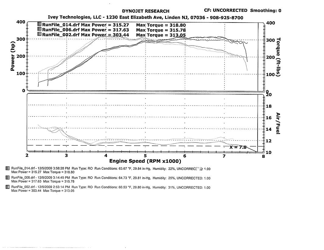

Why questions is 25 pounds on the stock VIII turbo too much? The car seems to run fine and I assume when this cold weather goes away i might even come down to 24psi with out touching the mbc.
The car dynoed on Ivey's dyno with the previous tune from Mellon wich when he tuned the car did not have the cams in it! I just wanted a dyno tune to dial in the cams etc. and get some numbers...
-so baseline pull was 303.44whp and 313.05tq
-After the retune 317.63whp and 315.78tq
I think one of the pulls that he did that is not shown on this graph he got 321whp and 318tq but maybe it was knocking and he pulled some timing added some fuel?
He said that the gas that I had in there may have been "bad" because it was inconsistent with some low count knock. There was heavy traffic that day and I was driving down the lynden NJ from VT took a little over 4 hours with traffic. So I stopped at the first gas station one i finally got over the George Washington Bridge and filled up because i had no other place to go.
Ive posted the graph below.. unfortunately the network scanner I have here at work does not scan in color which is SUPER lame. But ill work on a color version and try to post that.

that does seem odd...
so a baseline pull was done with the old Mellon Tune that was completed a long time ago before you had cams did 303.44whp and 313.05tq
then the Ivey retune (with S2 cams) was 317.63whp and 315.78tq
That car should be in the 350+area, was a boost leak test done with an air compressor?
25psi is not pushing it too hard.

I was not able to do a boost leak test before I went to NJ for the tune but I have done leak test periodically because of my constant paranoia that I have a boost leak. Chris I don't know if you remember the trouble we had finding the boost leaks in my car that basically ended up being TB shaft seal and a few other minor spots.
These previous tests are basically useless now though because this was all before the cam install was done. I had the head off as well to do a head gasket because we didnt realize there was a shrater valve in the compression tester so there was no pressure in the cylinder and CLINK went the first valve when doing the springs on the car.
So basically I need to check for leaks which I will this weekend when I return home for the holidays.
But I was expecting a little more gain from the retune with the cams. I mean just the cams alone untuned the car already felt WAY different and pulled hard down in the midrange anyway. I didn't want to push it without a solid tune.
Sean said the numbers were right on par for an VIII with cams like these, and my biggest restriction was my HFC. Said i would get a lot of gain from a test pipe and a UICP? I thought ive always read that the UICP wasn't really that big of a restriction. Of course i don't believe everything I hear.

Although it does not sound like you gained much from the new cams and tune (based upon the the peak numbers), what does the power curve look like ? Did you gain a lot in the mid range ?
Something does not sound correct - 8's are supposed to really benefit from cams as the stock profiles are very mild.

I have attached a shot of the dyno graph that includes a base pull and the final pulls. Although its in black and white they are all pretty close as you can tell.
I didnt seem to gain much in the midrange either. From what it feels like to me is that the car pulls almost like it did before the tune (to be clear this means with the s2's installed but a previous tune that was done before cams were installed) Only difference in feel is that it seems to be a bit smoother in power delivery, especially down low like while milking through the gears during normal driving. Not so much lag then boost constantly down low, just smoother. Sorry if that doesnt really make sense.
And yes i was under the impression that the cams are supposed to help the VIII's quite a bit too. Which they certainly did, I don't need a dyno to tell me that I can feel it for sure. But the tune itself didn't really give me any gain. I mean were talking 5hp or tq.
I was always told the tune was the best bang for the buck. I just spent quite a bit on 5hp/tq lol
I dont really want to get hung up on the numbers but I do feel like something is up here. I just want to car to perform like it should with the mods I just put in. I wanted to bring the car to another level that could keep me satisfied for another year or so.
I am sorry, but I may be misreading your statement... Did the 'baseline' dyno numbers have a Mellon tune for 25psi and the new S2s installed and then the final numbers just tweaked the tune for the S2s ? If so, then I understand your results....

I tuned the car before it had cams a long time ago, Ethan installed the s2's and did a baseline dyno pull with my old tune still on it. Then he had Ivey tune it for the s2's. I haven't tuned it for the s2's, but I'm very loyal to my customers and would like to help him figure out what's going on because I really think the car is capable of more. My guess is that there's either a mechanical or octane issue, I think Ivey did the best he could with what he was given to work with.

This is correct. Mellon's tune was at 23psi. The base line pull was with literally no changes to anything involving the ECU or MBC.

To OP - Well its hard to say since the baseline already had a solid tune and the s2 cams. Had you done a true baseline with the stock cams, then you'd be able to see the real gains...
