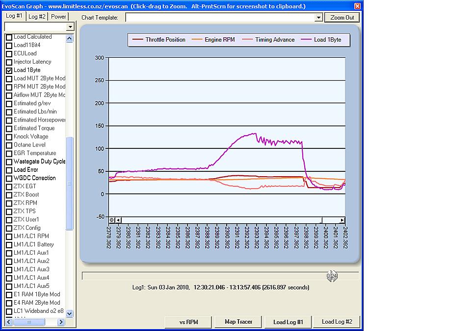

2 questions about this screen capture
1, the high points of timing, high points of air flow correspond to low points of load.
is this an indication of poor log response? or something I don't get?
2, using v706, is the stuttering a result of the bov? wgdc was 100% across the board.

whats up with the TPS? was this this a WOT run? it seems like your not getting anywhere near 100% throttle.

oh no its just a cruise up a hill. well its a mountain pass road.
