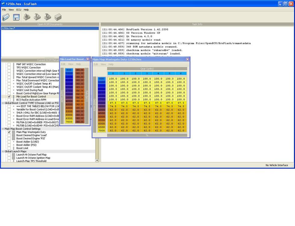

ok let me back up for a second.. i have the "under this load" WGDC stays 100% - set to 200. i have attached a screen shot of my WGDC table and my min load for boost control. if the WGDC is staying at 100% until i reach a load of 200 which is around 3300 RPM...
so essentially it's never at "0"... and then according to my WGDC map it stays 100% until about 3K rpm.
at 3K my logs are way above "86 load" so BC is already engaged.. how am i still hearing the pulsating?
Attached Thumbnails Figured it out: Low boost false knock (aka low boost flutter)-ecuflash.jpg

It's 0 until boost control activates. When it does, it stays 100% until 110 load. After 100 load is follows your WGDC map. So as soon as you pass 2750rpm over 110 load, you aren't at 100% anymore.

so wouldnt lowering the min load values for boost control to say 0 for all.. always engage boost control and eliminate the pulsating?

Maybe I'm misreading you but I just want to clarify that the pulsating is the WGDC clicking on and off. At 0 it's always OFF and at 100 always ON this is no sound. This has nothing to do with boost control being on or off. It has to do with WGDC duty cycle between 0 and 100 which make it pulse on/off about 20 times per seconds, at different on/off times depending on duty. That's what you are hearing.
If you hear pulsing at WOT solving the issue isn't by tuning, it's about sound deadening the solenoid.

i dont hear the pulsating throughout the whole WOT pull... i hear between 3K- and 5K RPM when the BC is adjusting WGDC. once it obtains a fixed value and im at peak boost.. it stops.
