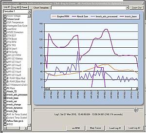

Need help with knock
Euro spec Evo VIII Rom 96532706
Knock Multiplyers at 18 low 24 mid and 28 high
How can it register a knock event when the Knock base and Knock adc do not cross ?

Log knock voltage as well, that will tell you if you are in fact are generating knock...

it actually does cross, evoscan is too slow to pick it up, DMA will show that it does in fact blip over knockbase.
