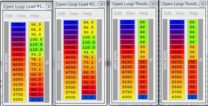

Old Apr 12, 2010 | 04:17 PM
leecavturbo's Avatar
Joined: Mar 2008
Posts: 1,392
From: uk
hows this?

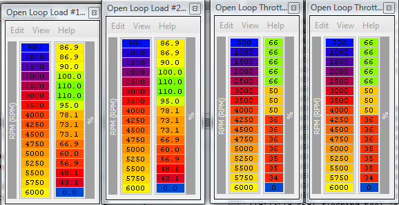

Old Apr 12, 2010 | 04:25 PM
lan_evo_mr9's Avatar
Joined: Feb 2006
Posts: 1,097
From: MD
Mine look like this...
Attached Thumbnails fuel trims seemingly not moving in evoscan-open-loop.png
