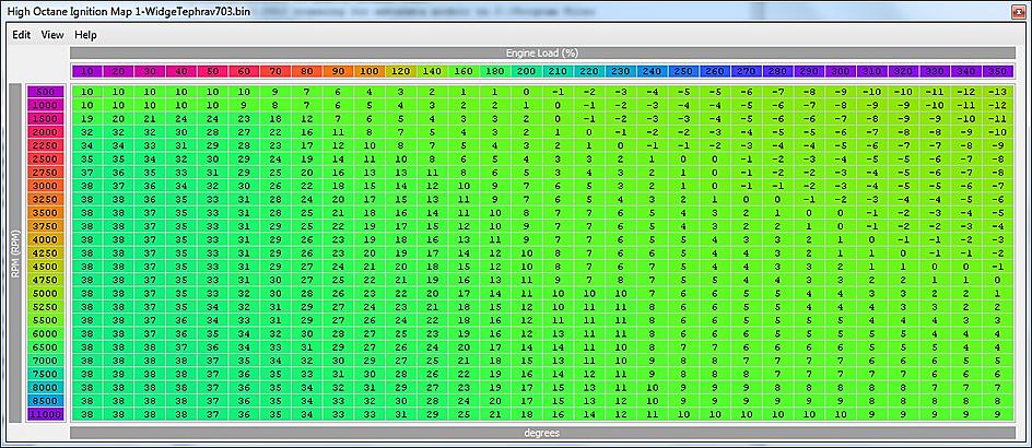

The only thing i can suggest without seeing your logs is i was having the same issues, i have now resolved them with tuning, but in some areas of your timing map its jumping around by 10 degrees, now ive always been told to keep it as smooth as possible.
Here is my map for reference, im in Aus with some mods on an Evo 8 fuel is 98oct here which is about USA 91oct and its not finished esp up top thats why its a little choppy.
If the motor starts knocking it will generally knock the whole way through the pull so you need to try and stop it from knocking at the first point.
I still think my map is a little week and i didnt get to finish tuning as i blew a vac line so i had to go home and havent been back out since
Anyway heres my Timing Map

Originally Posted by widge
the only thing i can suggest without seeing your logs is i was having the same issues, i have now resolved them with tuning, but in some areas of your timing map its jumping around by 10 degrees, now ive always been told to keep it as smooth as possible.
Here is my map for reference, im in aus with some mods on an evo 8 fuel is 98oct here which is about usa 91oct and its not finished esp up top thats why its a little choppy.
anyway heres my timing map
