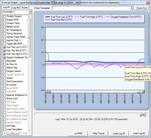

You are out of trim completely. With your LTFT low being -7 and your mid not changing....your injectors are not set correctly.
What intake and injectors are you running??

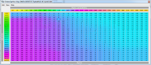

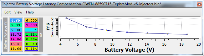

Injetors are afi 1000cc. I did another long drive and long idle after tweaking the injectors a bit. I have posted my ignition, fuel, etc... as well as a log snapshot.
Attached Thumbnails AFR changes when in different gears-latency.png   AFR changes when in different gears-fuelmap.png   AFR changes when in different gears-ignitionmap.png   AFR changes when in different gears-trims.png

From the looks of your tables....you are RICH and TIMID. We can help you unleash the beast within.

-3, -5, -8* @ peak TQ... WTF is w/ all of the - timing??? and looks way rich... dude, when we get done w/ ya, your gonna love ur car...
Edit: havent seen a mod list, so you might actually only be hitting the 240 ish cells...
