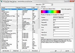

Can you post a pic of your MUT table and your data entry for 2-byte logging in evoscan?
By data entry I mean this:

here you go
Attached Thumbnails cant log 2 byte load?-evoscan-edit-data-settings-www.limitless.co.png   cant log 2 byte load?-mut-table-my-stock-evo-8-rom-2nd-mod.png
