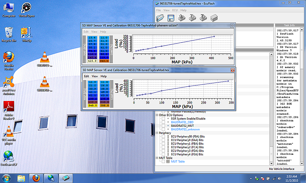

I am interested in the answer to this too. I have been looking at different SD MapVE setting and it looks like the values used in Schiedes thread are for the JDM 3 bar. The reason I think that those setting are for the JDM map sensor is because I just downloaded a fresh rom and the MapVE scaling were completely different from the original SD rom that I downloaded.
It seems that the roms are currently set up for the Omni 4 bar now, can anyone verify this?
Edit----------------
So I just downloaded a fresh SD96531706 and compared it to the rom that I am currently working on and noticed that the scalings are different. It specifies that the 94171715 roms are set up for the Omni 4bar but it doesn't specify that the 96531706 SD rom is set up for the Omni 4bar.
The bottom MapVe scalings are what im working on and I don't think that I changed anything on the left hand side. The MapVe on top is a fresh rom that I just downloaded.
Edit------------------------------
So i got the scalings figured out but now my 80 Load% is showing 0-1psi of boost and my 90 Load% is showing 2-3 psi of boost. Now if I can figure out how to get those areas to move over to the right to the 100 Load% I will be good to go.
