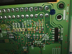

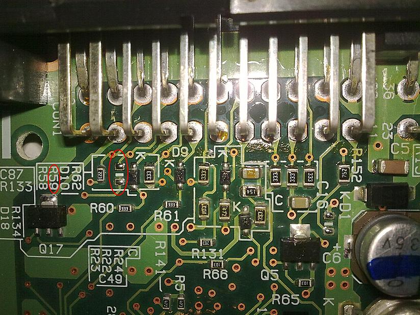

Would it be possible for anyone to open JDM AYC+ACD ecu and
take a picture of R54,R57,R59? USDM/EDM model does not have them.
Attached Thumbnails EVO IX AYC+ACD missing components help needed-missing_down.jpg   EVO IX AYC+ACD missing components help needed-missing_up.jpg

^acamus, on a JDM7
R59 = 33k
R54 and R57 are NOPOP ie empty
