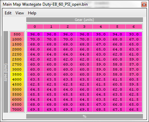

Start low and work your way up. As a comparison, here is my WGDC table. in 1st-3rd gear I'm boosting to 23psi up to 4500rpm then smoothly tappering it to 20. (stock turbo). 1.6 bar is 23psi, so you could try taking my map and lowering it by 10 accross the board, then do a quick pull from 2500-3500 in 3rd and go from there.

Just start very low and work your way up. I wouldn't borrow someone else's settings. FYI, 60% WGDC is well over 30 psi (2 bar) on my car. The openness of your exhaust in particular has a huge effect on the WGDC settings you need.

You're on a Black though. He didn't mention an aftermarket turbo, so I'm supposing he's on the stocker, as am I, so using my map - 10 across the board should be pretty safe while still being in the ballpark. Worst case, it's just a quick pull to 3500rpm, I doubt it would do much damage if it went over a couple psi.

Start at 30WGDC across the board.
