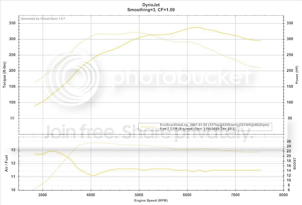

Here's a VD of the current street map.
Cheers.

Here's a quick 2-3-4 pull of the current state of tune too.

Ok checking back in with what I think is the final result.
Did some logging/tuning in the middle of the day today, was ~83*C, nice Aussie summer day.
Dropped boost to ~22psi peak, ~21psi held from 4k to cutout.
This 3-port is pretty mean when used properly, holds boost better than most a/m EBC's i've seen.
Pulled a degree and smoothed some of the timing in the 3.5-4k and 5.5-6k zone as it was a bit knocky at times.
So final a/f and boost graph.
And just to show off, 3 back to back boost curves over ~20mins.
Old Jan 6, 2011 | 09:09 PM
philr8's Avatar
Joined: Feb 2009
Posts: 245
From: NZ
see at 6500 rpm it went a little lean (not much but could be enough), looks like it pulled timing as you have a huge dip in your hp. Do you have the raw data log
Old Jan 6, 2011 | 09:15 PM
tscompusa2's Avatar
iTrader: (22)
Joined: Oct 2005
Posts: 5,375
Likes: 10
From: pa
make the rest of the afr curve match the dip at 4k now.
