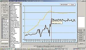

I have a 97 gst with an Evo 8 ecu installed. I'm running an Omnipower 4 bar map sensor, just bought 11-16-10. I have it logged with Evoscan, all values are correct. It will read correct randomly with my mech Apexi boost gauge. Once it starts mis-reading, it shoots to 4x.xx PSI and just fludders around up there. No CEL's, seems to run fine when its doing this also.
Rom: 96532706
Log:
*** I cant post the rom and log itself, so heres a screenshot. ***

are you using the 4bar to log boost or to run an SD system? are you certain that you modified the ROM definitions in the ecu and scaled the definition in Evoscan properly
and you are certain that you installed a legit omni 4bar... if you scaled the definition and everything correctly but still have a 1bar then when teh sensor reads 4v+ for 14ish psi it would make evoscan think your running 40psi

also a poor ground would cause stray voltage at higher rpms and that would also make evoscan read higher voltage and show a higher psi...

Assuming your are reading the correct MUT channel, the value is just an integer 0-255 which is 8bit indicator of voltage 0-5v. If it is fluctuating wildly, then either
a) the voltage of the sensor is flucating
b) the sensor is wired incorrectly (and probably (a))
or
c) the DAC is broken.
Have you plugged in a multimeter to see what voltage your getting from the sensor? Checked to see whether it matches the values from MUT (take out the scaling, just print the raw value)
Voltage = 5 * MUT_VALUE / 255
Once that works, its just a matter of scaling to match psi or kPa. Use the Omni 4bar thread to find it...
