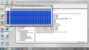

Exclamation what is that ????
any idea what is that and why ?

Wrong addresses/scalings (because of wrong xml), as well it is strange to me to see EvoIX ROM that is 256kb, from what I've seen EvoIX ROMs are 512kb.
I suggest you trying to hunt the correct .xml for your ROM image.

Ok that what i get from stander ecu , see the RPM it show 2559 all the way and load show 204 why???

wrong def file attach the rom on here
