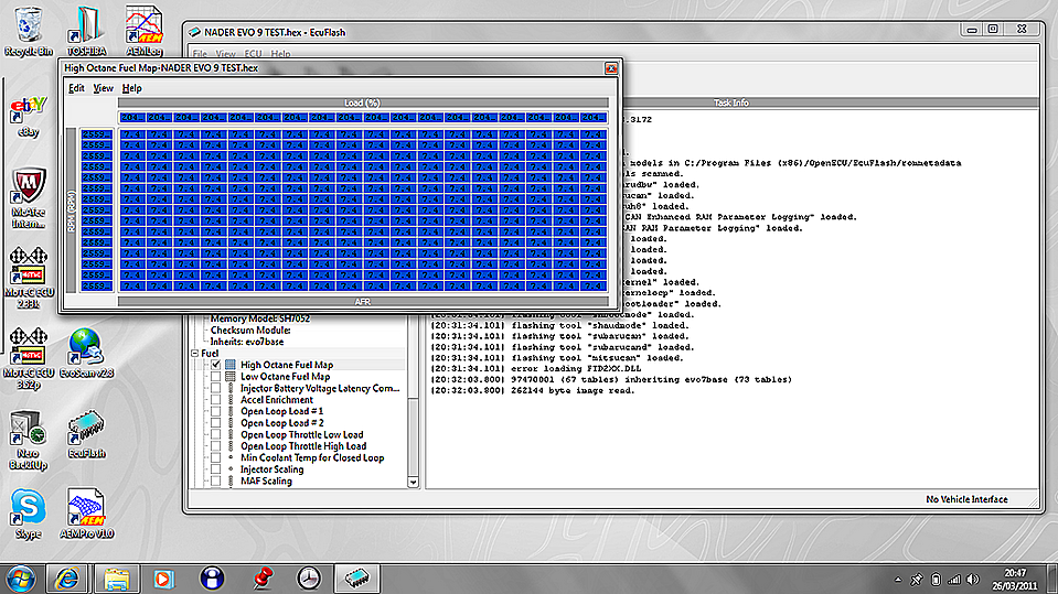

ok there is some of car's i'm trying to run the ecuflash on but that what i get (attached)
some pepole said it's becose of the wrong xml file so is there any way to rectifi that. Please help

from the output on the screen it looks like you 9 rom is inheriting an evo7base, so what you need to do is open the xxxxxx.xml (what ever your rom ID is) and in the first few lines you should see the comment inherit (at present it will say evo7base) change this to evo9base (or what ever your 9 base xml is called), you'll have to look in the xml evo directory, and that should solve you problem, if not let me know the ID and I'll take a look/send my xmls over
