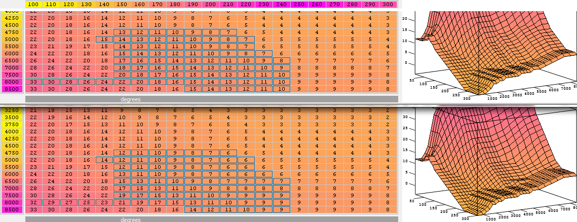

Shift knock can be mostly eliminated by lowering timing in the 150-190 load area where shifting occurs. I can post the relevent area of my timing map when I get home tonight.
I've tested this on my car and someone else's with pretty good results so far.
Old Jun 8, 2011 | 06:26 AM

good hint.. waiting for your screenshot

Pic of my timing map with changes highlighted as promised. "Before" is on the top and "after" is on the bottom.

In my opinion, that is too much timing decrease, is it worth it to have such drop in timing just to have NLTS?
Is it possible to set different NLTS drop values for each gear change? Tephra 5.10 include one drop value, does V7 include more?
+1 on that
You seem to imply that there's a negative side to reducing timing in that area. Am I correct? It's not like it really affects power, it's in a rpm/load range that is rarely seen.
v7 has only one drop value.
