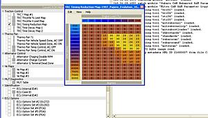

I´ve been slowly mapping it with Merlin´s latest xml, a couple questions though:
1) In the first xml in this thread there was a 2D table that could have been Mivec, this table is shown below and is now labelled TRC Timing Reduction; so it implies it lowers timing at given times to mantain traction?
2) Have you guys found the Mivec 2D table?
3) In a couple weeks I will install a 2.5" freer flowing custom exhaust, and will be logging AFR with a wideband, so I would need to log VE in order to calibrate the fuel map with WB. Do you guys have the Evosacn Datalist item description to log VE?
Thanks for your help!
Ricardo

Yes, it seems that way. With Merlin´s xml you have two TRC tables that represent tps with regard to load and rpm (both tables are the same, just one is in tps % and the other in volts). I´ve been playing with this tables and it does affect the auto mode shifting, specialy downshifting when accelerating. This way I´m limiting the areas in 5th gear when cruising at 1500 rpm or below, if you start accelerating lightly (above 21% tps for example) I´m making it downshift sooner by lowering the tps % in the rpm/load points that correspont to it. This way there´s better response by downshifting.
So it would seem that the TPS% in this table is regarded as the max it will take and remain in the same gear, go above that for a give rpm/load point and it will downshift to accelerate faster. Hence the name of the tables "throttle % or V limit map".

Ricardo, I dont think there is a MIVEC table, just the switching points as shown in the xml.
Have you tried zeroing the TRC timing table to reduce/eliminate traction control?
Good find on what the TRC throttle table does, I did not realise it affected gear shifting.
