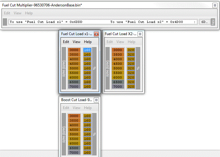

Probably not the IAT, you have the factory boost solenoid in? Also, do you have the fuel cut set to something that your loads are hitting? I think it's called "boost cut" or "load fuel cut" or something like that. How did you get onto SD without some amount of tuning btw?

Lean under boost? The thing with SD is that it's sooo "car specific" from my exp. One cars map may run totally different on another, which was why I asked how you were getting by no tune. So, you don't have access to ecuflash and a cable though I am guessing, since the shop got you a map? Do you have a wideband? What makes you think it's lean, if you don't have a wideband (if you do have one...I obviously know why you think it's lean, lol.) You said you have to do some datalogging, so it could go either way I guess.
hearing "wastegate pressure" and then seeing 25psi after it just makes my jaw drop, lol...I'm so used to my 7psi.
Since I run such low PSI, I see about 150-160 load...so this is my fuel/boost cut table. There is also other "stuff" that could be cutting, like rear O2 wired from a wideband, and fuel cut when it's outside of acceptable range....but you'd know if you had stuff like that setup. And...besides, you aren't hitting a "boost cut" cause you are on WG pressure, it would have to be fuel cut like in my attached pic.

I understand that SD tunes are car specific. I'd think that I'd a least be able to boost 5psi without issue though. I have Ecuflash and am borrowing a friends tatrix cable, and have loaded a few different maps from the tuner to try and resolve this issue. I have a Zentronix wideband o2 sensor that is currently not hooked up. The rear o2 sensor is disabled and I am running the heater simulator patch. I believe it is running lean simply based off of what a friend of mine believes (and he has a fair amount of experience tuning Evos). Anyways, not trying to waste anyone's time here. I am simply trying to brainstorm here. I know I need to make it to the shop for a complete tune. Not sure when exactly that will happen so I'm looking for maybe a quick fix.
