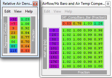

as the problem appeared after it got cold over here can't it be some kind of other compensation tables fault ?
can anybody explain how these tables act and what to change in them ?
Relative Air Density vs Temp for Airflow/Hz
Airflow/Hz Baro and Air Temp Compensation
