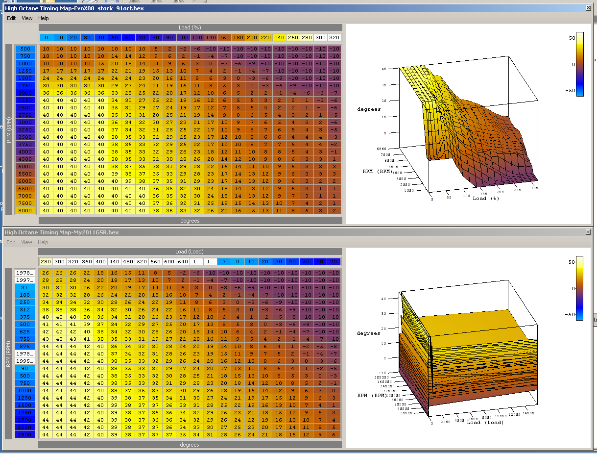

Hey I'm new to the forums, drive a WW 2011 GSR. I recently got my tactrix 2.0 and wanted to look at the stock maps and such my romid is 56890013 but I noticed that when I open my hex using 56890010 both axis get messed up (mine is on the bottom). Should I just flash to an older hex like a 010 instead of trying to use the 013? Any advice would be greatly appreciated.

wrong scalings for the rpm and load. change them
