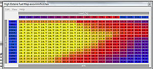

I have two problems with ecu flash and my tuning stay freeze.
First the pop up window with vehicle type is empty when trying to log ecu, by ecuflash.
Second I download the ecu image with other laptop but when i open the image with ecu flash some values 'I think' are not correct. Take a look on rpm and load engine values.
RPM: 395, 461, 2559.., 1364.., 2559...,1406..., 105, 0, 39,78,117,156,195,234,273.
LOAD: 41,43,47,50,53,56,59,62,66,69,72,74,78,80,204...,1 09...,204...,112...
ecu id: 96260007
Thanks Haris.

What version of ECU flash are you using?
You need the XML definitions in order to read your ROM correctly.
Try to update them with a more recent version of ECU flash or by downloading special XML definition (Tephra, etc)
Cheers.
