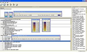

So I'm starting to wonder if my computer is doing something weird or if something is going wrong in the DL process....something.
just the other night, I dl the 94170715rom directly from the V7 thread, copy over the tables and flash the car.

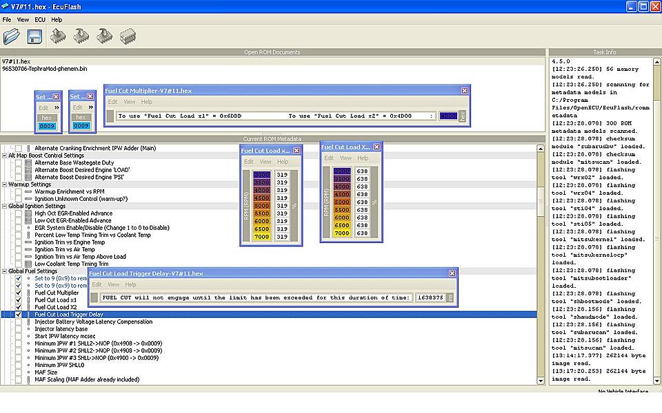

now, no matter what i change or try the car seems like its hitting boost cut. yet ive got the timer for boost cut maxed out, the load limit maxed out, the multiplier set to "2x", and i removed the load and fuel max's. (see first pic)

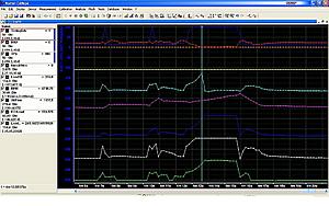

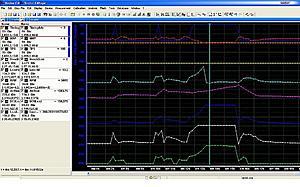

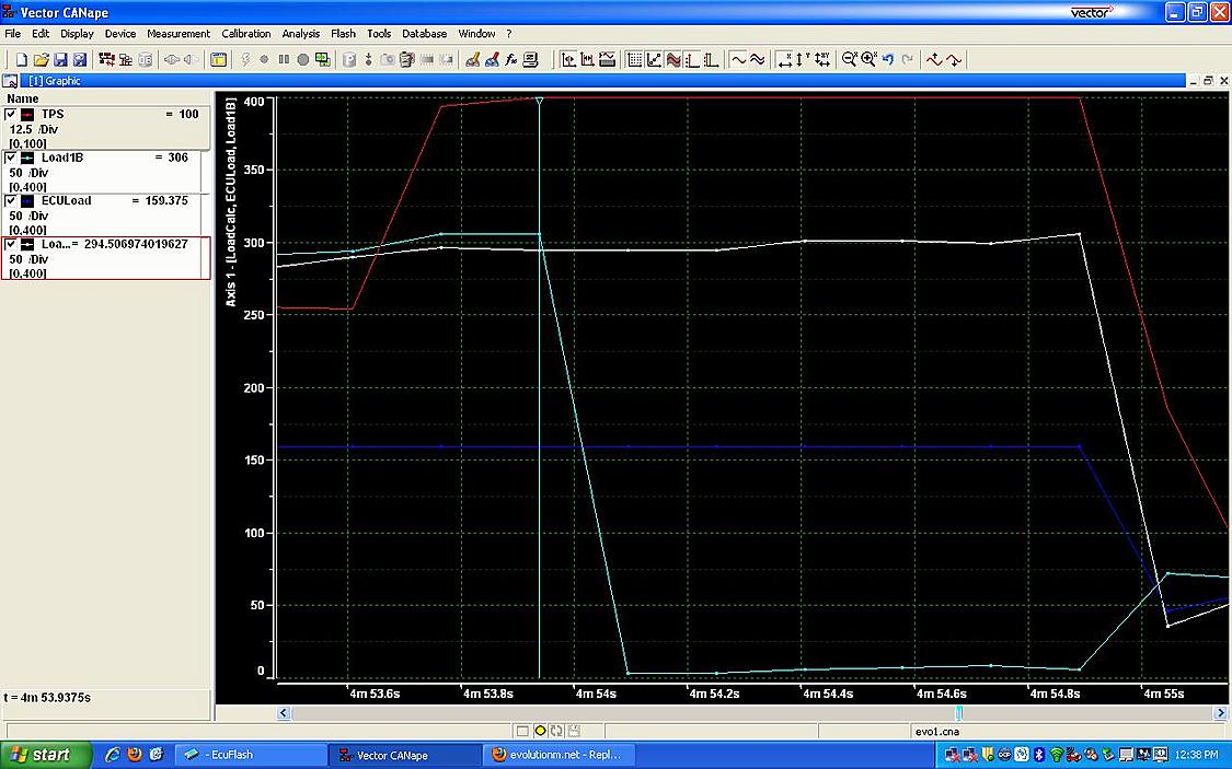

and if you look at the 2nd and 3rd pics (click on the links) you'll see that the car starts off fine but then 1byte load drops to nothing yet ECU load and Load calc continue on just fine.
https://www.evolutionm.net/forums/at...nder-wot-1.jpg
https://www.evolutionm.net/forums/at...nder-wot-2.jpg
any ideas? any suggestions? any one have this happen to them?

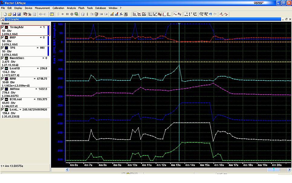

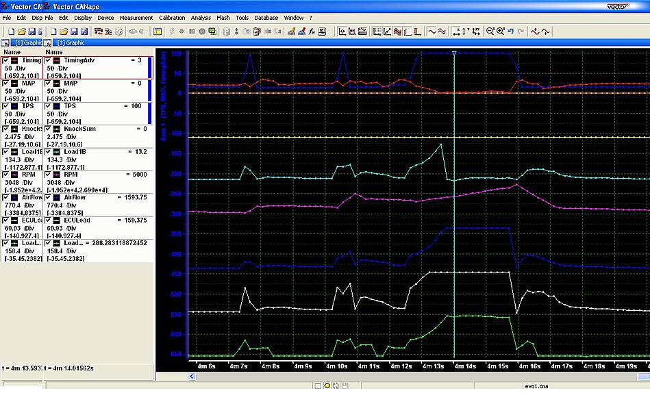

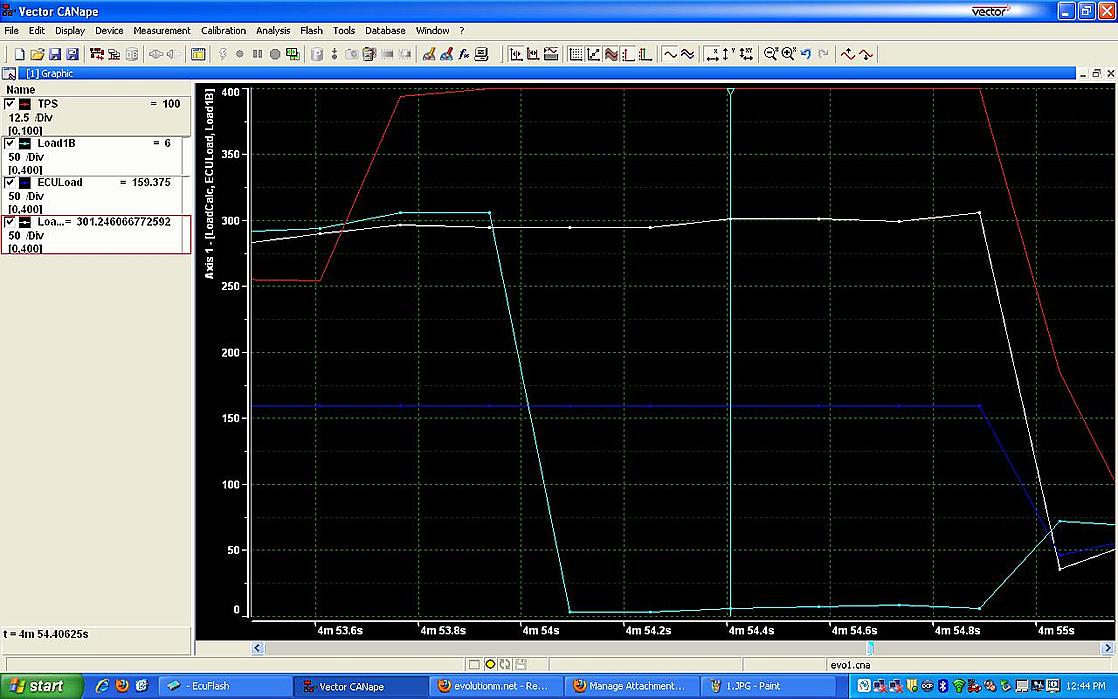

welp, the first one is just load over run (255*1.2=306) but here is another pull at a 1.4 correction for 1byte load and it still does it. but at 256% load.
Attached Thumbnails weird load issue round #2!-4.jpg   weird load issue round #2!-5.jpg

for some reason, swapping to a different Evo8 rom 96530006 fixed the issue.
beyond weird and frustrating. absolutely annoying.
