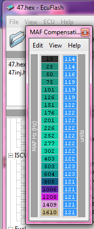

Sure, which screens would you like to see? Im gonna go try another rom with the MAF comp adjusted like you say. I added some fuel at low HZ ranges, but wont that just make it want to pull more fuel in the end?
Old Dec 16, 2012 | 07:27 PM
211Ratsbud's Avatar
Joined: Oct 2010
Posts: 4,286
Likes: 43
From: Watertown, NY

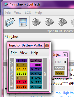

heres a couple
I have these latency values in an E-Mail from PTE. They supplied the voltage vs ms and I entered that explicitly into ecu flash today.
Attached Thumbnails Injector scaling vs actual afr in close loop? Also does ve change closed loop fueling-inect.png   Injector scaling vs actual afr in close loop? Also does ve change closed loop fueling-maf-comp.png   Injector scaling vs actual afr in close loop? Also does ve change closed loop fueling-ve-map.jpg

this is the latency which yielded this log. The data in this ROM was previous to the rom posted above.
Yes I modified the voltage scaling in the above post per PTE's recomendations.

I wish this were the case with 100% of the injectors out there. It seems our ECU needs more fine tuning as there are a lot of factors and off the shelf standalones deal with off the shelf latency values better from what I am told.
1) you can adjust your MAF COMP a little (lot) more that you have done.
2) try my latencies for PTE 1200's as a starting point which net me excellent drivability and idle (even on e85) get ready for a retune lol. if your happy with your current tune, just work with your MAF COMP values until you/the ecu finds stoich. then adjust your VE, fuel, and load to open/closed loop tables to dial in the tip-in. also, verify your exhaust is well sealed as a pinhole downstream will affect the upstream readings at idle more than one thinks:
3.312
2.184
2.088
1.296
0.792
0.72
0.48
scaling: 1044 (you will have to go down on this as per the 1000cc/min rating).
