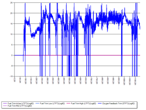

so lately i have been wanting to see how bad my MAF is off. i have done everything correctly as far as setting it up in my rom. at first i thought it was because i was simulating my rear o2 sensor. so i re-enabled it and still nothing.
i have a 03 eclipse GS with a DOHC swap running a evo8 16g. tenabe DP, HKS SSQV2 BOV, evo 8 internal WG, injent IC piping and intake. Currently have the rear o2 simulated and deleted. i am running the tephrav7(rom 96530706).
any of you guys ever run into this problem?
i attached a print screen of my logs. in the logs i have the first log which was about 15-20 min of city/fwy driving staying in closed loop.(first log i have my rear o2 sim disabled and the rear CEL enabled.
in the second log it was about 20min driving in cty/fwy staying in closed loop.(second log i have the rear o2 sim enabled and disabled the rear CEL. Attached Thumbnails
