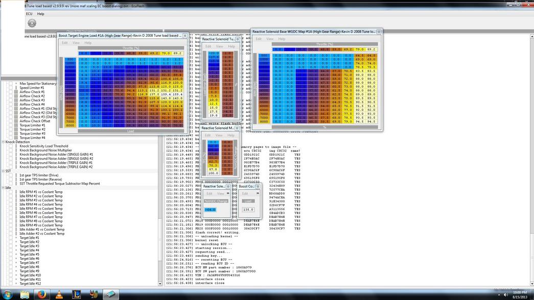

I'm trying to flatten my boost out, but I need some help. On my logs after I shift I get fluctuations from a spike of 27 to a taper to 17. Can anyone help me out?
Any suggestions would be great!
Mods List : AMS CAI, AMS Upper / Lower, Buschur 7" FMIC, AMS Widemouth DP, AMS Test Pipe, Fujitsobo Exhaust, Synapse DV (w/ yellow spring), Forge Piston WGA, Cobb 3 Port,
Kevin D 2008 Tune load based v2.9.9.9 rev (more maf scaling EC boost dialing).bin

your Boost is tapering because it you have it setup to heavily taper. Boost is based off your WDC and then corrected using your Load target table.
Get your load target to 150 all the way til 7k and your taper will go away.
