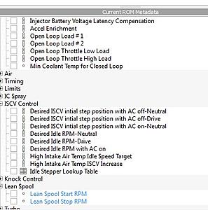

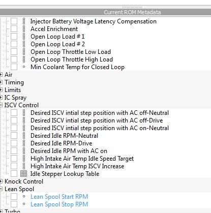

I have installed JUN 264 cams the idle is loopy, i have changed the hi and low octane maps changed to as rich i can get but the ecu still hunts for 14.7 but just at the starting 5 secs it hits 13.5 and after that 14.7 - 16.
Every one on the forum is saying i should advance the timing till 12 degrees but infact what i have noticed the car is lacking fuel in the idle area. Advancing the timing the car cranks late and raising the limit the water temps climb fast at idle.
I NEED TO RUN 13.5 AFR at idle [ with out wiring the wide band sensor with ecu. not good at electronics ]. Which table should i fiddle with to achieve the desired... The rom is 93360005.
Require assistance please.

Have you let the car sit and idle for 20 minutes to set fuel trims?
Old Jun 30, 2014 | 09:34 AM
mines5's Avatar
Joined: Oct 2010
Posts: 870
Likes: 23
From: Streets of willow
Not 20 but 15 minutes.
If i change the values 500 - 1000 rpm cells of open loop load # 1 and #2 to -9.5
So the open loop will operate for these rpm ranges above -9.5 load ?
Similarly if i change the throttle low and hi load 500 - 1000 rpm cells to 0 from 1.62 will this bring in the open loop for that rpm range ? or on the load 1 and 2 tables will do the job?
What temp should i put in for min coolant temp for closed loop ?
Which condition does the ecu responds to first ? the load tables or the min temp ?
