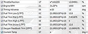

Hello everyone,
My ride is an evo 9 EDM 2006, equipped with a full BBK turbo, M2 cpsworth cams and 1000 CC PTE injectors.
ROM : 88840017
Fuel type: 95 RON
I'm suffering from a puff of black smoke on acceleration
(I hate black smoke)
Scaling, latency and map are attached.
I tried several parameters in latency and scaling (790, 812, 835) but in vain.
As you can see now I have the fuel trim positif and still the black smoke is there ....
The table "accelerator enrichment" is greyed out. Do you think that this parameter if it can be adjusted willl affect the black smoke?
Or do I have to replace the injectors with smaller cc ? (what size do you suggest?)
Please advise

What is your air-fuel ratio when in boost? If you don't have a catalytic converter, you will have black smoke, simple as that. You can't fix it by changing scalings, latencies, accel enrich, etc.
And yes I have the fujitsubo cat less exhaust.
As I understand from you that I can't get ride of the black smoke even if I fit smaller injectors.
No, using smaller injectors won't change anything because they will still have to squirt the same amount of fuel for a given amount of air entering the engine.
The only thing you can do is re-install a catalytic converter.
