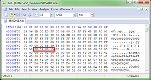

To identify the ROM you will need to save the ROM that has been downloaded into ECUFlash. The "use ROM without definition" option selected in the screenshot is the correct option to use, so from that dialog with that option selected click the "Next" button. Then use the "save ROM" command button to save a copy of the ROM (it should be 512kB in size for a 9).
Then you need to use a hex viewer and look at the 4 bytes starting at offset 0xf52 in the saved ROM file. For example (using an ID I believe is for an Evo 9), if the 4 bytes are 0x88, 0x58, 0x00 and 0x15 the ROM ID would be 88580015. Once you know the ROM ID you can google the ID or ask where to find a definition file...

If you don't want to install a hex viewer on your PC, I'm sure a little googling will turn up a website that will display all or part of the file in hex format via an upload - if you do this select one that can display just the first 4096 bytes (the ID is just below that point and there's no point in trying to display the rest of the file).

Perhaps a screenshot (for example, 88590015.hex) might help...
Thanks. I will open mine back up and check it out. The screenshot sure does help.
I did do it and found that mine is a 96940011.hex. But one thing that does not make sense to me is that from doing research that is an EVO VIII rom file and I have an EVO IX. Plust I have that rom file and it still has not opened my .hex file I have read from my ecu.
