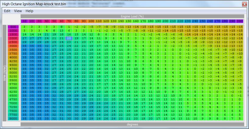

Car is running on 98 ron and 1.5 bar boost. i have also attached the timing map which has been set to 5 deg less to make sure it is false knock.

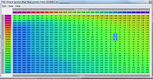

As mentioned before i don't believe this to be real knock. i have attached the ignition map the car has been driving around on for 4 years and i was seeing the same amount of knock on this. i then decided that i wanted to stop the knock flashing my check light on the dash. i then reduced the whole ignition map by 5deg (second map) to make sure i was not going to get real knock whilst increasing the knock multiplier map to try and eliminate this knock. After reducing the ignition i did not see any changes in the knock i was seeing. i have increased the filter slightly and have seen a reduction but it is still there on occasion.
So i will try adding fuel to eliminate that but my main question was how far can you increase the multipliers before the knock sensor will stop picking up real knock

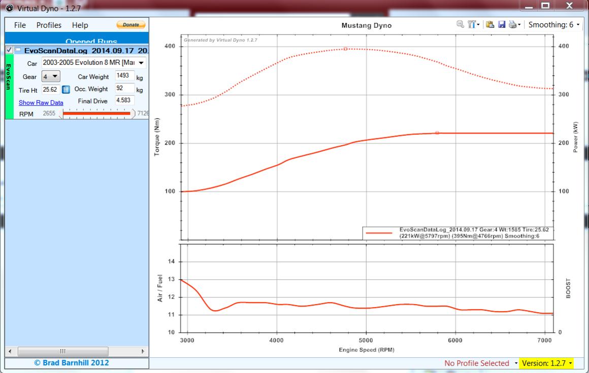

All good now.
I cleaned up the AFR's and reduced the timing heaps then dialled out the phantom knock by increasing the multiplier table. Also used DET cans to listen for real knock. once i removed the phantom knock i added timing till i heard real knock and the knock sensor picked it up at the same time. i reduced the timing a little from there and ended up with the below outcome.
this is tuned on 98ron and running 25psi and dropping to 23 up top
