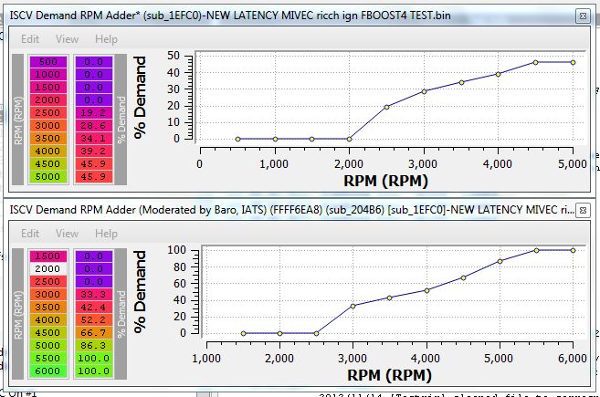

Hello everyone,
My rom is 88840017 Tephra 5.5
In order to get rid/minimize the throttle hang and since I couldn't find these tables anywhere (for my rom) I decided to do some researches and comparisons and I came out with both of the below tables:
<table name="ISCV Demand RPM Adder* (sub_1EFC0)" category="ISCV Control" type="2D" address="41fc" level="2" scaling="ISCV_AX2_8">
<table name="RPM" type="Y Axis" address="6c82" elements="10" scaling="RPM"/>
</table>
<table name="ISCV Demand RPM Adder (Moderated by Baro, IATS) (FFFF6EA8) (sub_204B6) [sub_1EFC0]" category="ISCV Control" type="2D" address="694e" level="2" scaling="ISCV_AX2_8">
<table name="RPM" type="Y Axis" address="0805a" elements="10" scaling="RPM"/>
</table>
This is the link to download my rom:
https://drive.google.com/file/d/0B43...it?usp=sharing
Can someone check them out and inform me if they are correct.
Thanks in advance
Geo

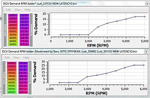

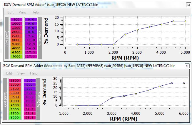

To all of the guys that are suffering from the throttle hang on the 88840017, my discovery is the answer.
Since No one replied to my cry for Help, I decided to take the risk and do the test;
And with great pleasure I inform you that it was the solution.
Attached the values I have used that solved it.
I've tested it and used it at my own risk so please be aware and do the same.
Kind Regards
Geo
