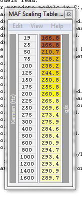

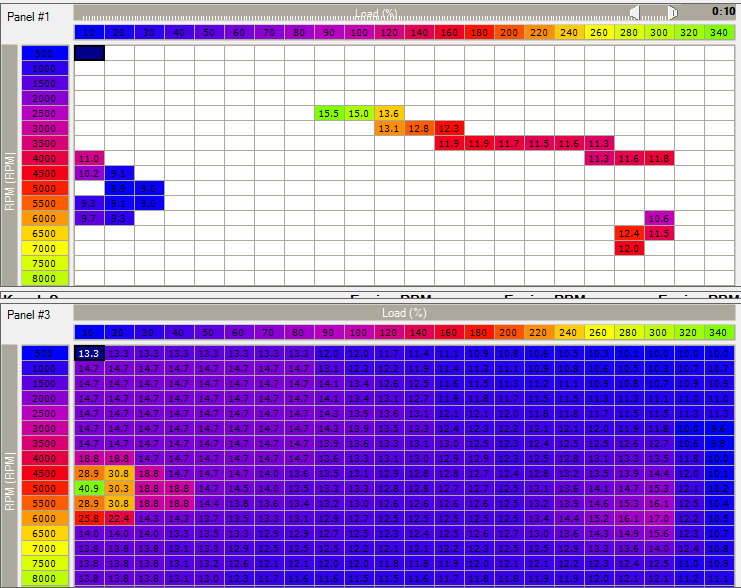

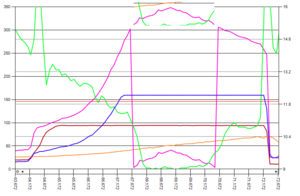

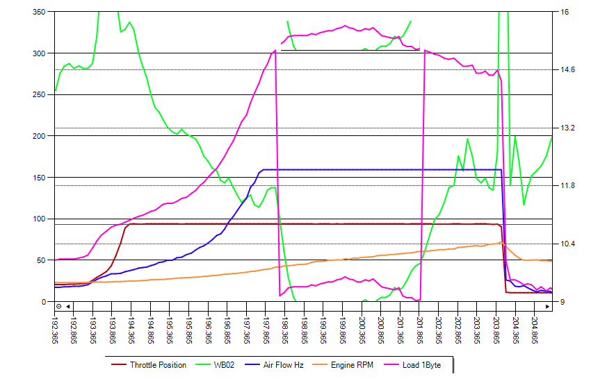

car in question is a 99 gsx. stock black box ecu running ceddymods big maps. 2.3L. Hx35. 3" Gm maf w/ translator.
once it hits around 303 load it drops to 10-30 load and once it goes down to 306 it normalizes. Has anyone ever seen something like this happen? I can understand if it ran out of map but theres still a good bit left. I've also tried tuning at the location it drops to but it refuses to respond and still drops to 9afr
Attached Thumbnails 1byte load goes to 0 above 4k-snip.png   1byte load goes to 0 above 4k-snip2.png   1byte load goes to 0 above 4k-snip3.png   1byte load goes to 0 above 4k-maf.png

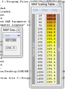

that option isn't in the dsm files. But I'm currently good until 340 load. It shouldn't be limiting it to 300. I did some reading and found out that ecu load is limited by the maf. It's still set up for a stock maf which is 289. That might also explain why I had to scale my 1050's as 1100's. I'll try it this weekend when I get back.
What max load does 1.4 put you at?
