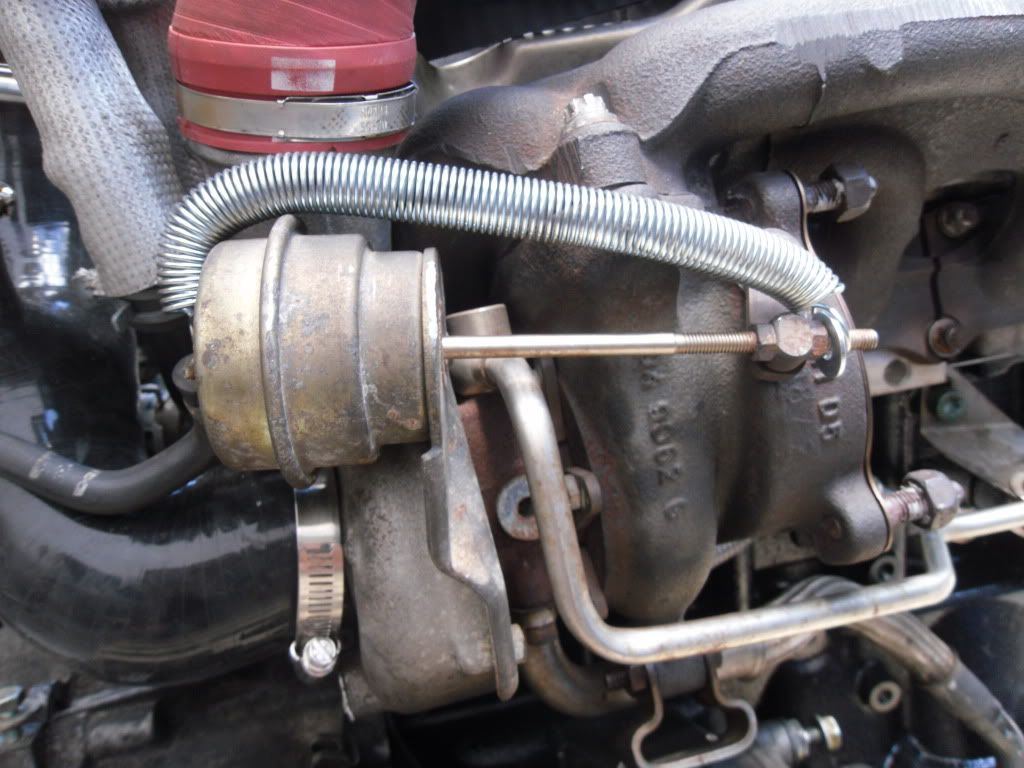

If I get another 8 turbo with an actuator I'll give it a shot. Otherwise I'll probably just upgrade to a 9 turbo w/aftermarket actuator.
In other news, I found this on a VW forum.

I've done the helper spring (on a previous build). Not strong enough and doesn't like the heat.
