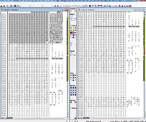

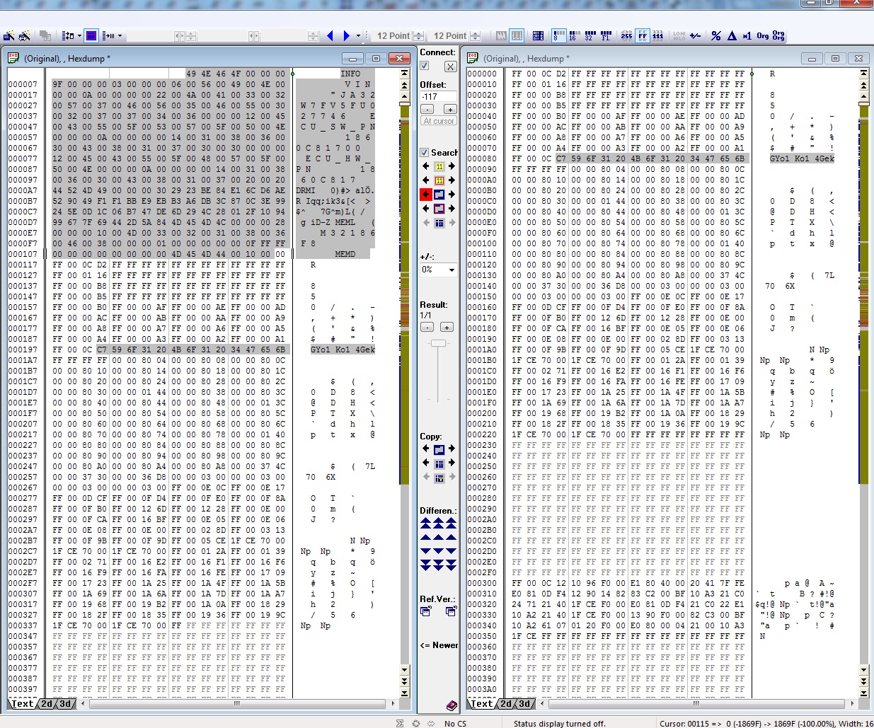

Rom Id is @ 50141...
Originally Posted by Justnii
Can you read from your ECU again and post the ROM again? It has some kind of memory issue.
No memory issue.
Vin, ECU Hardware & Ecu SW has been added in the beginning of the rom program data area. The whole data has been shifted. If anyone else has a 2015 FE model Evo, could you post up your stock rom for comparison?
In the picture, the 2015 FE is on the left and the mem dump on right is a 2014 GSR stock read

Thank you. took a quick look with my map vector script. It seems the data in his memory on his ecu is modified. I don't have an idea who would put the VIN, HW, & SW in the beginning of the memory but it did shift the whole data points for the data, x axis, y axis, and table data.
The best thing he can do is upload a 100% stock rom/bin back into his car and use the xml you posted up for the 52680002.
I will post up a 52680002 I have in my repository. It is the only one I have for a 2015 FE That came off a supposed stock car.

I know this is an older thread but wanted to add some clarification in case someone else stumbles on this. The ROM with the shifted data is a SRF (Structured ROM Format) ROM image file. That's like a bin file with a header on the front. The header section contains additional non-ROM image info that can be helpful in decoding the ROM image data. If you open the SRF file in EcuFlash, you can then select the "File->Save As" menu option to save it as a bin, which would then let you do a direct comparison against another ROM image in bin format. When you do a read of an ECU in EcuFlash, you can save it in either SRF or bin format.
