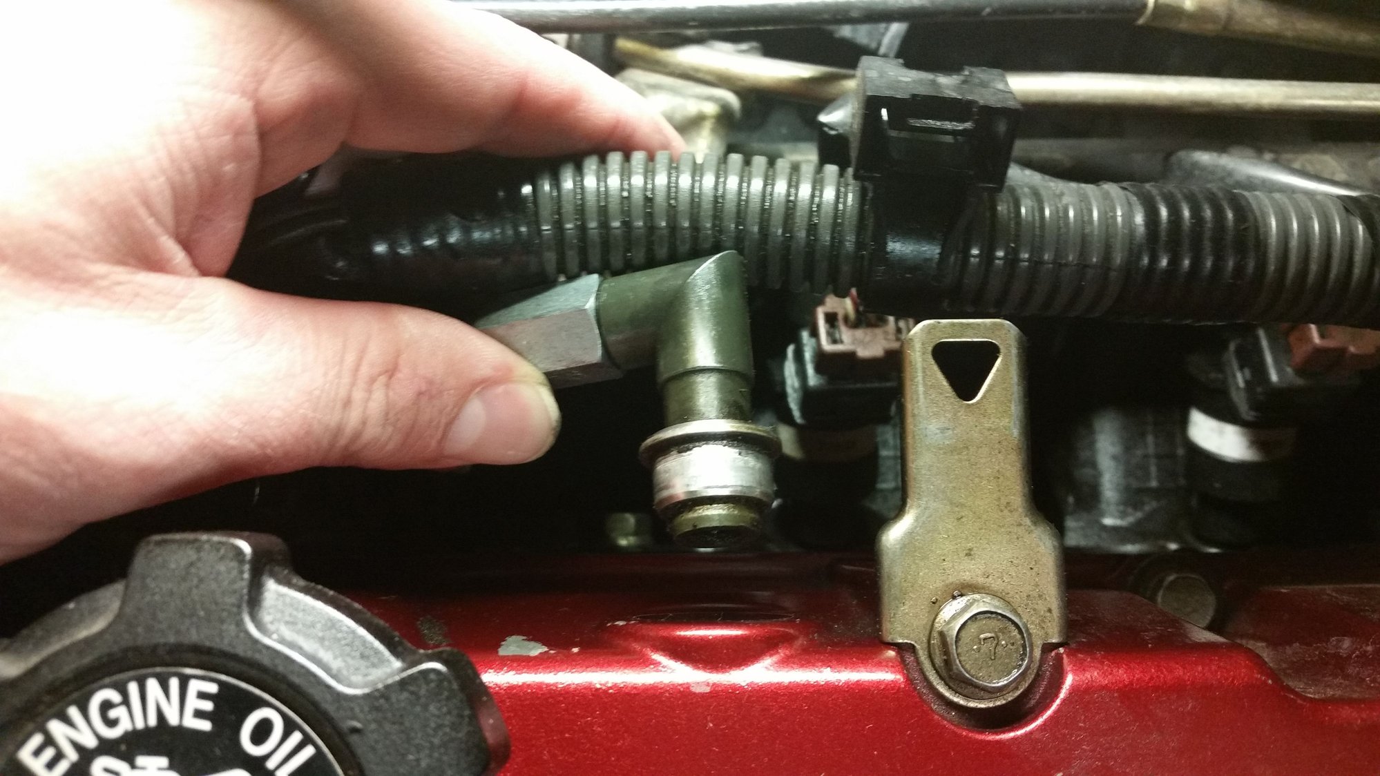

I wonder if this has anything to do with it???
I dont think that would cause load reading issues.
If it is caused by blowby, then theoretically the detonation within the cylinder would not be as strong, therefore not reaching higher loads?

If the PCV was disconnected you may run a little lean, also will throw off load, although not by too much. The pcv disconnected like that would screw up your values for anything 0psi-vacuum. As soon as you see boost if the PCV is working properly...the valve would close and load should be accurate. Under vacuum you are allowing un-metered air into the system which would make you run a little lean. Why did you do a re-scale? Also a value of 1.4 on the 1-byte factor should allow you to read up to 360 load I believe. Also the MAF is the way the ECU computes load on a non SD car. I am pretty sure your scaling is incorrect.
Won't argue with you there. Though I had another issue affecting this. My Exhaust Manifold was leaking. All lower bolts needed retorqued. Load, Airflow, and Boost seem correct now. However, still running lean. I have another thread stating the current issues with fueling I can't seem to find. Take a look at it. It's the unknown issue thread.
