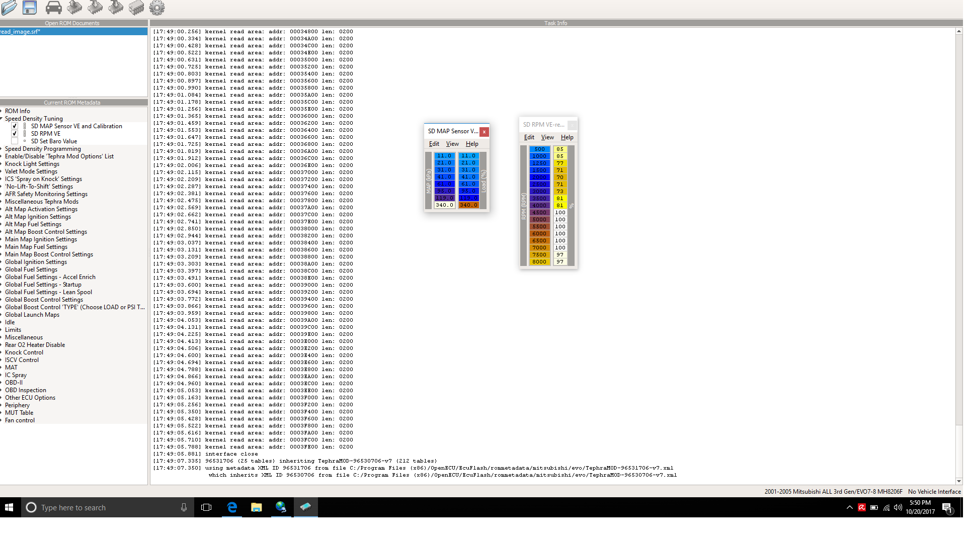

Doing some SD tuning and have worked myself in a circle today. I own multiple mitsubishi's and having paid multiple tuners to tune this car, as well as my others with less than satisfactory results, ive decided to tackle this car myself. It seems to scare some tuners away as its a 2g eclipse on an evo ecu with a 9653 ROM. It was semi tuned prior, but after going back and forth with the remote tuner i finally gave up as it was a chore to get setup with him. I've started fresh with the following-
98 GSX, stock long block, small 16g, FMIC, 3" exhaust, 1120cc FIC's, pump 91, JDM 3 bar map. The car is fairly stock, so i figure itd be a good one to start with. Im more so just looking for some direction and guidance, not someone to tune the car. I've spent most of the afternoon altering everything from latencies to VE and i keep going in circles it seems. If someone can look at this log and give me some direction thatd be great. I know enough to get me in trouble, as well as to know that my settings aren't correct, but it seems everytime i change something i just go backwards with something else. i've included a reasonable spectrum of driving in a short log. I disabled closed loop as the o2 isn't cycling properly, not sure if thats my settings or if it took a dump. advice? criticism?

Originally Posted by 4b11slayer
Post map ve and rpm ve
Posted, this is where I've started over with. I haven't touched the MAPVE as I've been more focused on getting the RPM portions lined up, throttle tip in and MAP change hasn't been an issue worth addressing *yet*

Dont listen to foreskin fred. Those map ve values are in need of adjusting.
Set rpm ve to 100 from 1250 to 7000 to 100.
And adjust your afr with just MAP VE. Dial in afr via MAP VE then fine tune fuel.trims with rpm VR
Old Oct 20, 2017 | 10:53 PM
4b11slayer's Avatar
Joined: Nov 2015
Posts: 1,787
Likes: 89
From: Santa Ana
Expecting you have good previous good injector scaling and latency. Your trims should be near 0. Now you jump into sd. Set rpm ve like i said too 100. Now go and do wot pulls in 3rd gear from 2k. Do it in increments. From 2k to 4k. Adjust map ve till your afr is good from 2k to 4k. Then raise the bar from 2k to 6k. And so on until you get to redline. This needs to be done with a good known octane map that goes richer as load goes up
Also your timimg map need to be conservative until you dial in a safe afr. Then once afr is safe you add timing advance. To mbt.
As ive learned the map ve will make your load go further to the right on the ignition or fuel maps.
Start over the weather plays a big toll in the speed density game. Dont give up and keep reading.
