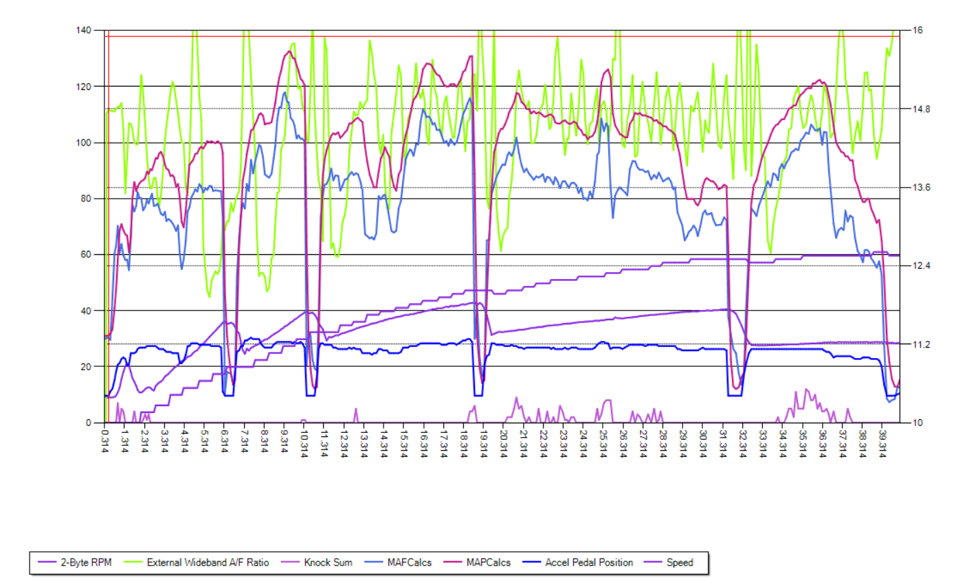

Hi,
I'm a complete noob when it comes to logging and tuning. I just recently got tunned with some new bolt ons and decided to take some logs and noticed some knock sum (up to 10~15) at partial throttle (20-30%) when going on to the freeway. Is this due to a tune issue or some other issue? I have attached a picture of the graphs. Any help or pointers will be greatly appreciated!
Thanks!
seeevo
knock sum at partial throttle

At what load are you seeing knock. Could be just noise from your motor but if you are concerned talk to your tuner. Log knock voltage also.
